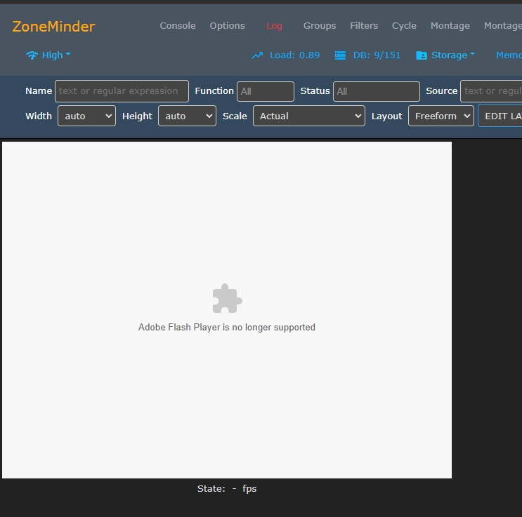

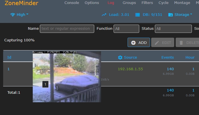

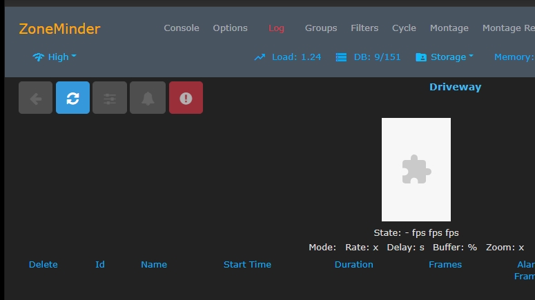

Aprox 3 updates ago broken ( Images) Was said it was a java error
No prob I rebuilt, previous update to one above was working.
I know it is Dev, just reporting whats happening
Max 3 images, see next also
console 1.jpg (107.13 KiB) Viewed 17588 times
console 1 click.jpg (72.09 KiB) Viewed 17588 times

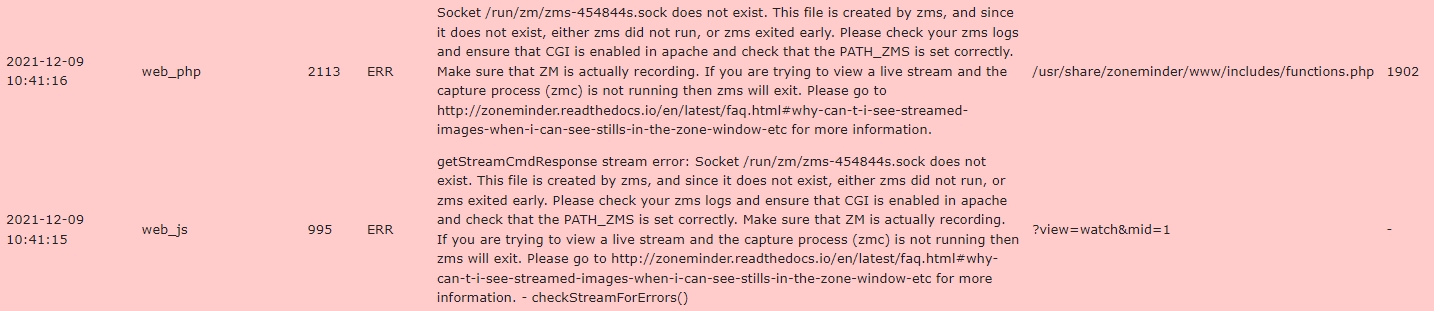

paths.txt
(942 Bytes) Downloaded 551 times

Adobe flash?!? That's so wrong. I am running master on Ubuntu 18.04 not seeing this, hitting it with various browsers from FF to whatever iOS uses (Opera?). It almost sounds like a browser problem. Clear cache, update browser? Flash should not be a part of the equation at all.

I think the flash thing is due to Options->High BW->WEB_H_STREAM_METHOD being mpeg instead of jpeg.
Due to flash being gone we are going to have to actually remove this code so as not to cause confusion.

iconnor wrote: Fri Dec 10, 2021 2:41 pm I think the flash thing is due to Options->High BW->WEB_H_STREAM_METHOD being mpeg instead of jpeg.
This is an older PTZ camera WI-FI if this one is the odd ball type throwing the error only for me I can replace it
https://sites.google.com/site/gsasalesm ... data-sheet
I can switch to mpeg-4, but never had to before but time changes.

Low and Medium bandwidth is fine

Updated two days ago from 1.36.17 to the 1.37.16 and had exactly this problem. Code is still there ...
Thanks for the hint with mpeg vs. jpeg, that did the trick.

Can confirm this is still broken with new deployments.
WEB_H_STREAM_METHOD must be set to JPEG
Only JPEG works, the default for High B/W (MPEG) does not, and continues to cause frustration.
