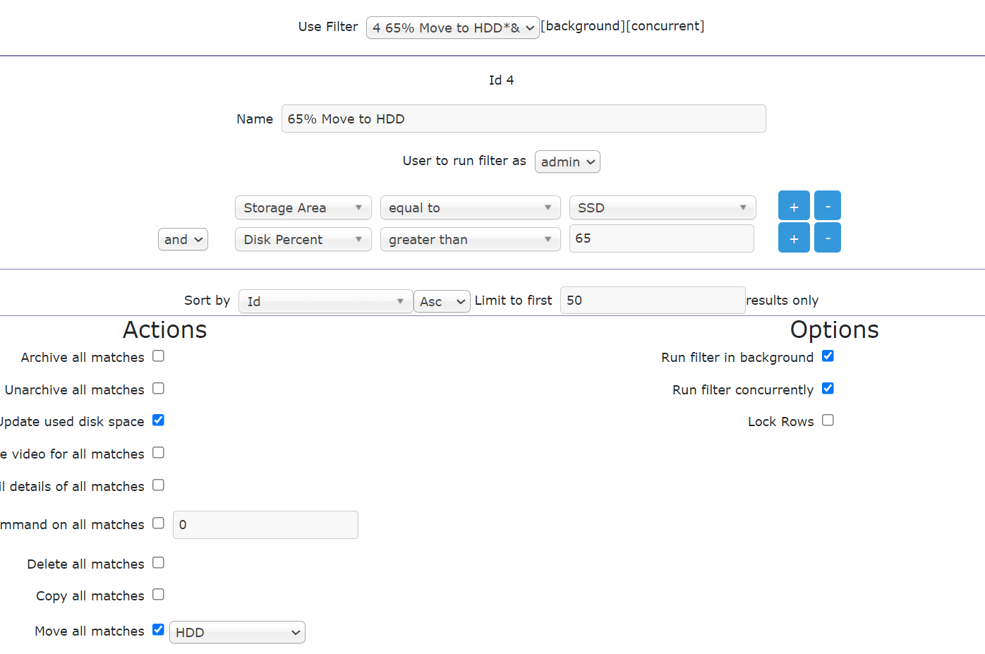

I have a filter setup to move events to another storage if disk percent is over 65, I lowered the percentage to test it and nothing moved, it does not log any errors that I see, it simply presents the list of events.
If I remove "disk percent greater than", I am able to move from or to either disk
I see also that I am continuously gaining new filter ID's that are running, I am up to 55 currently.
I'm at a loss, I had used this filter for a long time on my previous install
Thanks again all.
Screenshot 2022-01-17 123348.png (87.5 KiB) Viewed 8136 times

Turn off concurrently.

Nope, my brother and I watched the debug of the filter, disc percent is getting the percentage without the hard drive metadata.
Zoneminder percentages include metadata but for some reason disc percent reads from a different spot.
Do I have a bad file somewhere I can fix?
