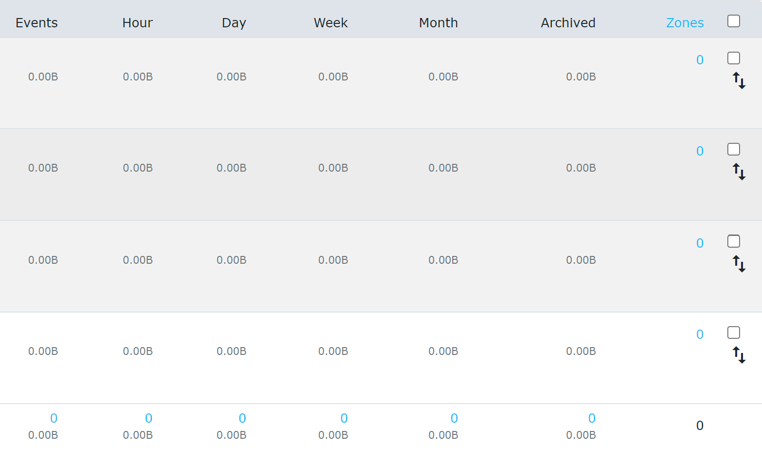

Console Showing 0.00B Across All Events
Post by FroZar »
Install details:
* Docker Image
* Using rockylinux:8.5 since Centos is deprecated
* Traefik as a reverse proxy
* Zoneminder version 1.36.12
* External Maria DB 10.7.1
I've seen this issue in the forums. I checked the timezone and it is set correctly in the GUI and on the server.
I turned debug on, but nothing is really standing out.
All other features are working.
What am I missing?
Screenshot 2022-02-10 105757.png (44.4 KiB) Viewed 29481 times

Re: Console Showing 0.00B Across All Events
Do you u have an Update DIsk Space filter running?

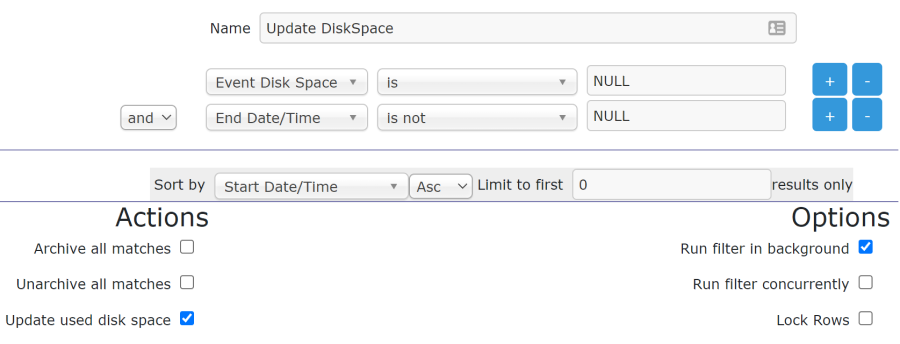

I also realized I do seem to have an Update Diskspace filter enabled by default I assume, however manually executing it doesn't update the totals on Console. Are these the default config options for the filter?
Posts: 1378
I dunno - maybe Limit to first 0 results is "short-circuiting" it? That used to default to 100.

Upping the limit to 100 doesn't seem to change anything. Showing the matches with the default query doesn't return anything, though getting rid of the Event Disk Space clause returns all events. However, when I execute this, it still doesn't update the counts.

Are you using the default disk drive for storage?
If not you may need to specify the drive. I have two drives and need to specify two updates to get them.
Also, there seem to be (or were) two "default" drives = null or = 0, depending on if you assign it in the monitors.

Screenshot 2022-02-10 105757.pngbasketball stars unblocked
The image you sent shows that Zoneminder is not able to connect to the MariaDB database. This is likely the reason why you are not seeing any events.
There are a few things you can check to troubleshoot this issue:
Make sure that the MariaDB server is running.
Make sure that the Zoneminder user has access to the MariaDB database.
Make sure that the Zoneminder configuration file is correct.
