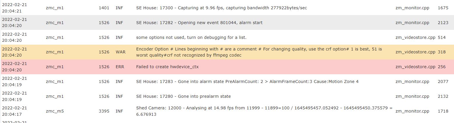

Here is a picture of the log with an error in it, if that helps.

Re: Video won't load
Have a look in storage part of each monitor. Optional Encoder Parameters - Remove all the comments and set something sensible.

Thanks. You got me pointed in the right direction. It was actually in the storage settings, but the output codec and encoder were both set to auto. Changing the output codec to h264 fixed it. Not sure why that would have changed during the upgrade, or why it broke, but that fixed it.

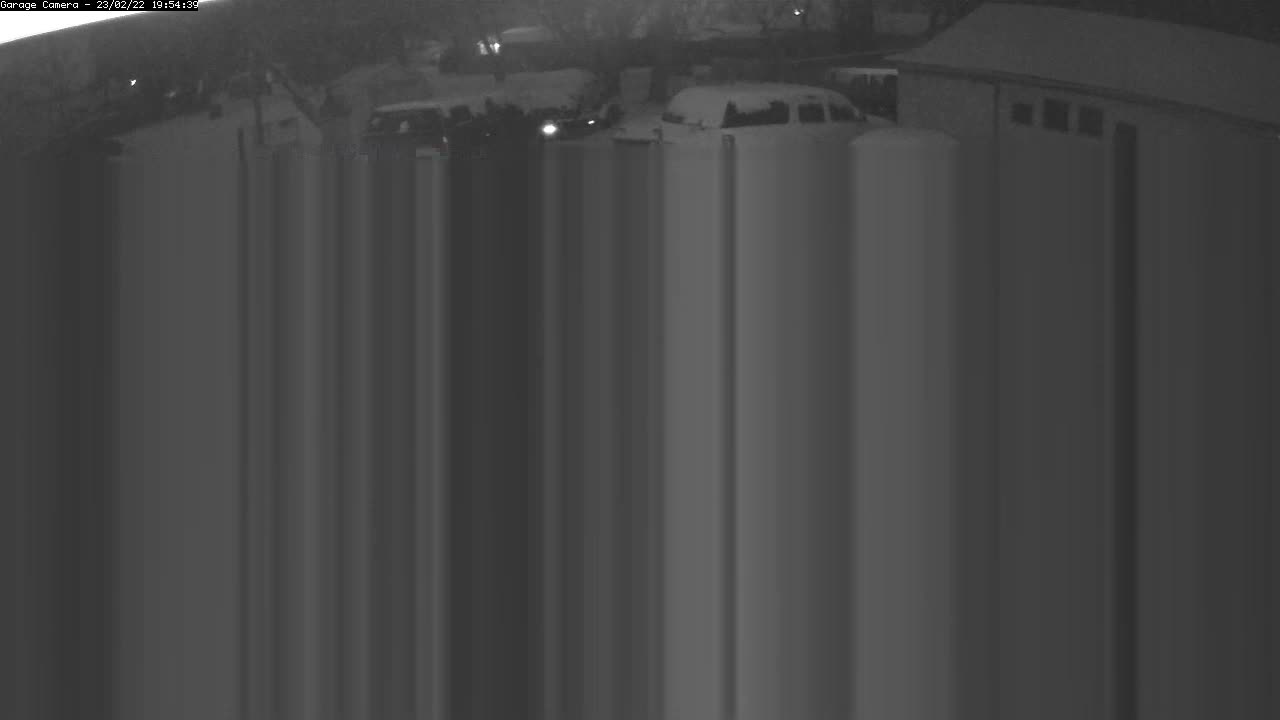

So, I thought I had it fixed... Now I am getting a lot of the clips via email and the recordings that look like this for a few seconds, then go back to normal. There is a also a blip of a message about not finding a file for a split second in the video also. Any ideas?

Strange thing is it's just one camera and the other 3 are the same model, and all of the settings look exactly the same. Didn't have this issue before the upgrade.
It’s a pretty common problem. Usually flipping TCP/UDP setting resolves. And make sure you are using FFMPEG not the older method to capture the RTSP streams.

Well, I tried the TCP/UDP switch, but ended up deleting the camera out and re-adding it, and that seems to have helped.
Posts: 1375
Check the key frame interval on the cameras. I’ve run into cameras were the same, but some internal settings were different for some reason.

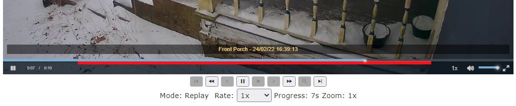

So, one other issue I found. For some reason this same camera that I readded has a different bar at the bottom on playback of recordings then the other 4 cameras. It has no time, camera name, pause button, etc. I thought re-adding it might fix it, but it didn't. Any way to fix this?
Posts: 1375
If you didn’t, try cloning one of the other cameras.
See if the bar is there. Then edit the clone as needed.

Well, cloning did the same thing....
Posts: 1375
Foo. Shot in the dark, if you re-used the monitor id, use a previously unused one. Maybe something stuck in the database?
