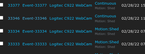

Also, I note that my motion detection Logitech C922 Webcam, which worked fine, previously, now seems to be capturing full time, not during motion.
This shows as an 'event' cause 'continuous' with an ever increasing number of frames with zero alarm frames.
I changed the 'capturing' setting to 'On Demand' with recording 'On Motion' (it was always set to On Motion) and the issue seems to have gone away.

That said, it seems to capture motion in the correct zone, creating events and I can review them.
The only problems are camera warm up time and what appears to be a never ending event in the event log (no end time).
The continuous frames event seems to keep going until a movement is detected, at which time, the event is closed off according to my settings, which is about 20 frames of no movement.
EDIT: as per event log, one can see when things changed...
and the continuous event with no end time, and seemingly endless disk usage...
This is promptly deleted by one of my filters, as it has less than 30 alarm frames.
I will admit to being somewhat concerned, if, overnight, no movement is detected. Will the event fill up my disk? At 7400 frames it has used 1.2GB, so far.
