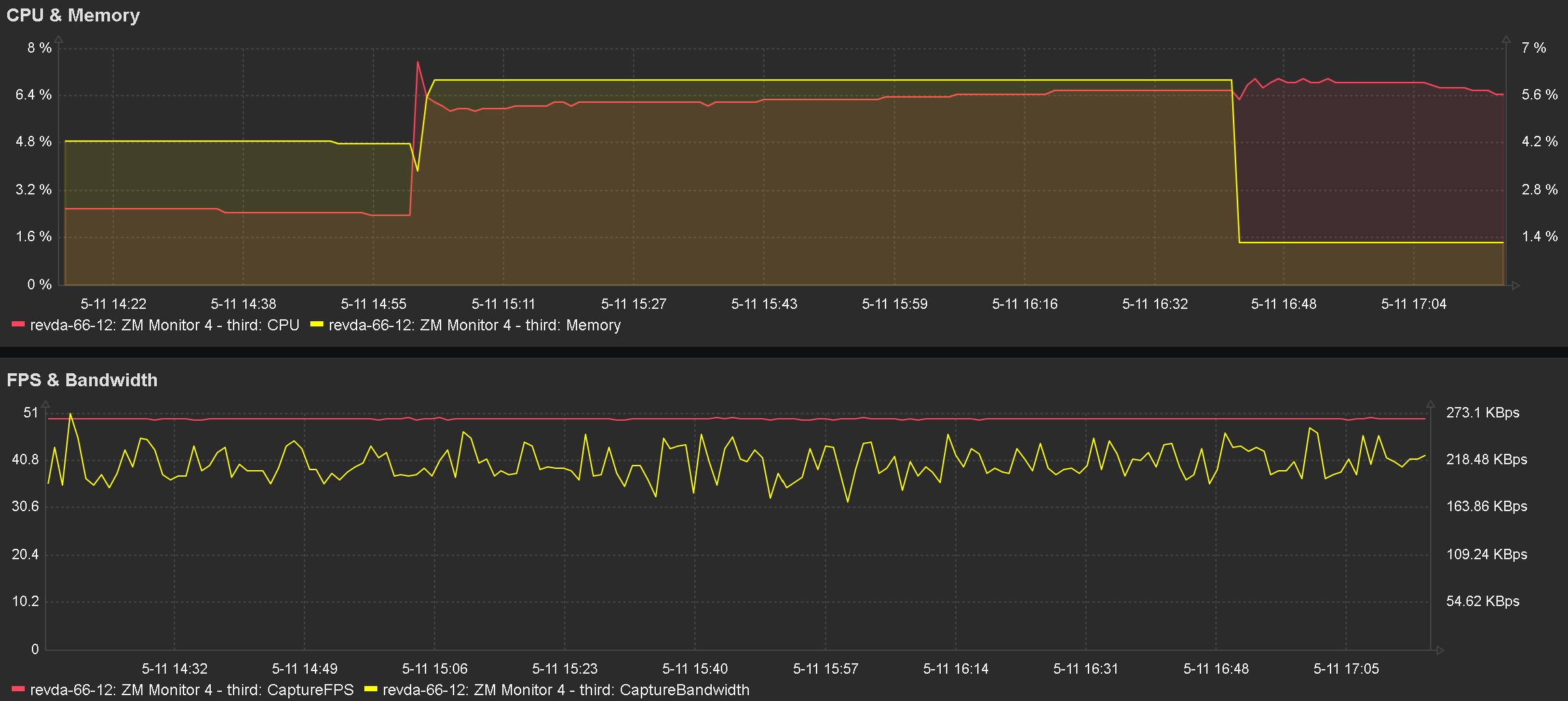

OK. More pictures. I've created a new Dashboard to illustrate different Decoding settings. No other setting are changed.
I have 6 servers with 8-12 cameras of different type, FPS and resolution on each, and I'm able to reproduce this behavior on any of them.
segment 1: Ondemand
segment 2: KeyFrames + Ondemand
segment 3: KeyFrames Only
more meaningful than thousand words. CPU is Red, Memory is Yellow
