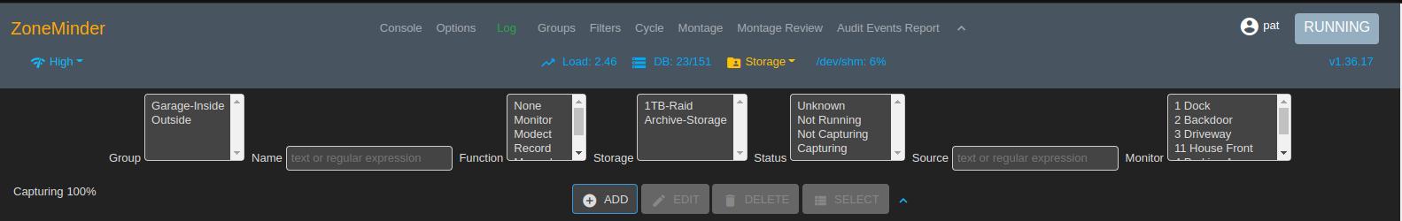

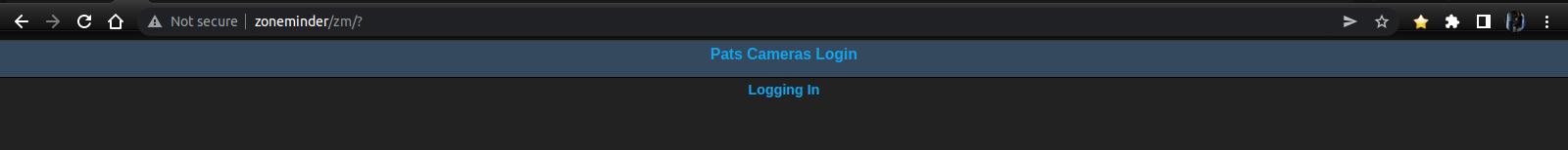

Upon updating to 1.36.16 on 2 different installations, we are no longer able to login. By deleting the ? after the /, the console would load. Once on the console, streaming loads an image and not the video. Changing the video size doesn't work either. On the console, all the selection boxes are open.
I've deleted all cookies and used different browsers, no luck.
Everything was working great on 1.36.15
Thanks for any ideas with this.
Logging in and it hangs here till i remove the ?
Group, Function Storage and Monitor selections all stuck open.
