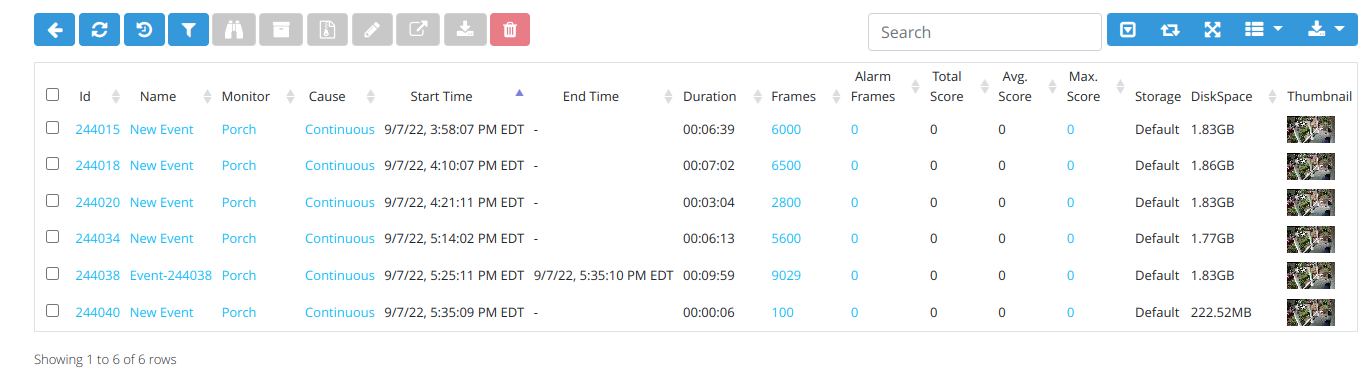

Here's a screenshot of one aspect of the event issue. I'm back on Mocord and typically each event should be 10 minutes (600 seconds). I've seen the system sometimes choke during analytics and as a result, segments will be smaller (resulting in missed footage actually) but generally I'll have a pretty complete record.
What is happening now seems to be completely random. I'm not getting the normal 6 events or so per hour and most of what I have does NOT have an end date/time. Its NULL... that now explains the purge filter failing but what would be causing this? The attached image was a display of events from the last two hours (run at around 17:35 local time). Note only 1 event got marked with and end time.

For science, I went back to mode Record around 11:05. You'll see that events are still spotty. I looked at event 244357 (the one highlighted) and the data was there. For some reason that event ran about 15 minutes and as a side note, the timebar over the video disappears after about 9 minute mark. The next event logged didn't occur until about two hours later (even 244392). Also note, none of the shown events have ending date /timestamps. I went to the logs and found this...
Sep  8 11:35:06 zm-nvr zmc_m5[70714]: INF [zmc_m5] [Front Door: 000 - Opened new event 244357, section start]
Sep  8 11:50:00 zm-nvr zmc_m5[70714]: INF [zmc_m5] [Front Door: 26895 - Closing event 244357, section end forced 1662652200 - 1662651305 = 895 >= 600]
Sep  8 11:51:35 zm-nvr zmc_m5[71021]: INF [zmc_m5] [Front Door: 000 - Opened new event 244361, section start]
Sep  8 12:10:00 zm-nvr zmc_m5[71021]: INF [zmc_m5] [Front Door: 33250 - Closing event 244361, section end forced 1662653400 - 1662652293 = 1107 >= 600]
Sep  8 12:10:39 zm-nvr zmfilter_1[65985]: INF [Deleting event 244361 from Monitor 5 StartDateTime:2022-09-08 11:51:33 from /var/cache/zoneminder/events/5/2022-09-08/244361]
So, there was an event started at 11:51:35 (244361) but the disk purge filter deleted it as well as many other event across all the cameras and I don't understand why since the only thing I did to the filter was lower the purge percentage to 55.
Screenshot 2022-09-09 01.05.05.png (134.6 KiB) Viewed 58745 times
My problem appears to be the same as this:
viewtopic.php?t=31686
and you mentioned there too turning on debugging there and restarting the filter. Can you tell me how to do that or point me to a reference?
Re: Released 1.36.25 The Memory Remains
Your filter says to delete events where the end date/time is not null. That's why these events with no end date/time get deleted.
Go into Options, Logging and set at least debug level 3 to help Isaac.

As for the event deletion. That makes sense but if that was the root cause then none of the events listed in the image would have been present. That filter rule has always been there and I presume that that is the default since events usually get an ending date / timestamp. Easy enough to switch to the start date / timestamp for now.

Posts: 3393
You have a filter deleting the events as they are created.

iconnor wrote: Fri Sep 09, 2022 4:44 pm You have a filter deleting the events as they are created.
I turned it off for now.
