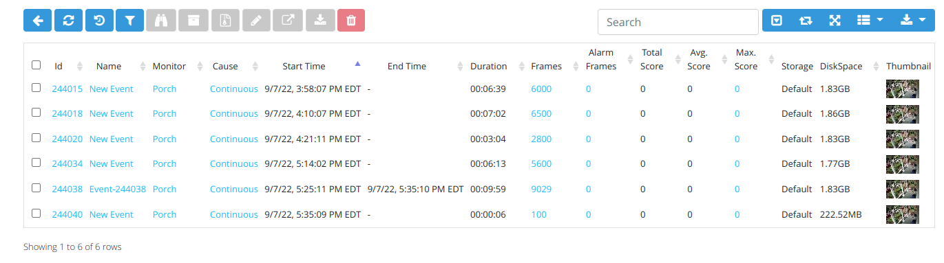

Here's a screenshot of one aspect of the event issue. I'm back on Mocord and typically each event should be 10 minutes (600 seconds). I've seen the system sometimes choke during analytics and as a result, segments will be smaller (resulting in missed footage actually) but generally I'll have a pretty complete record.
What is happening now seems to be completely random. I'm not getting the normal 6 events or so per hour and most of what I have does NOT have an end date/time. Its NULL... that now explains the purge filter failing but what would be causing this? The attached image was a display of events from the last two hours (run at around 17:35 local time). Note only 1 event got marked with and end time.

Sounds like something is crashing. I presume it’s zmc.

As to filters, look in your filter logs. Turn on debug, let's look at the SQL that gets logged. If you are using storage areas, then you have to tell it which area to look at.
As to the events with no end, zmc is crashing. Look in your logs.

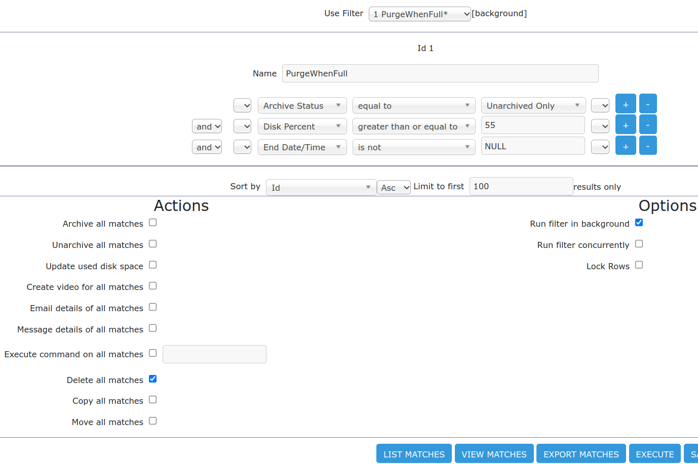

So, there was an event started at 11:51:35 (244361) but the disk purge filter deleted it as well as many other event across all the cameras and I don't understand why since the only thing I did to the filter was lower the purge percentage to 55.

Your filter says to delete events where the end date/time is not null. That's why these events with no end date/time get deleted.
Go into Options, Logging and set at least debug level 3 to help Isaac.

Magic919 wrote: Fri Sep 09, 2022 7:31 am Your filter says to delete events where the end date/time is not null. That's why these events with no end date/time get deleted.
Ok. Thanks for that.
As for the event deletion. That makes sense but if that was the root cause then none of the events listed in the image would have been present. That filter rule has always been there and I presume that that is the default since events usually get an ending date / timestamp. Easy enough to switch to the start date / timestamp for now.

You have a filter deleting the events as they are created.
Re: Released 1.36.25 The Memory Remains
Posted: Fri Sep 09, 2022 5:26 pm
by keithp
iconnor wrote: Fri Sep 09, 2022 4:44 pm You have a filter deleting the events as they are created.
I turned it off for now.
