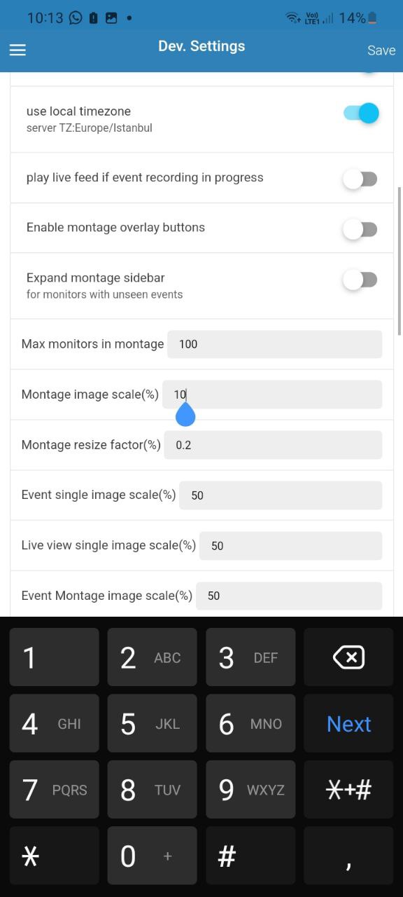

Edit2: Also, montage image scale is not going below 10%, and I think it has no effect. Below are comparison of montage view of 10% and 100% montage image scale.

Montage Image Scale Settings
