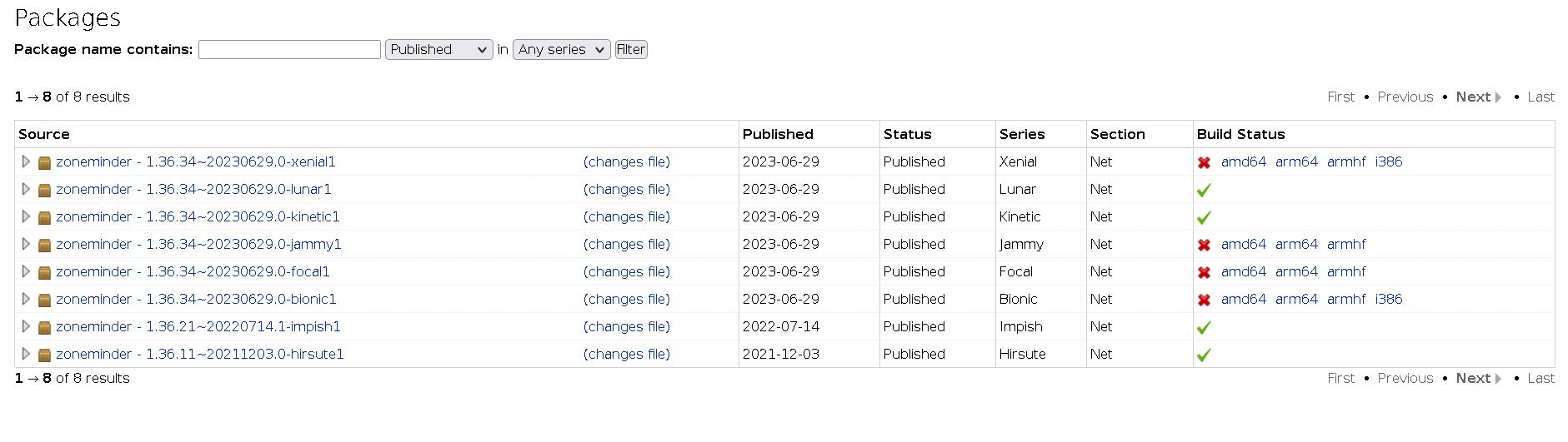

Re: Idea: Remove need for ?view= part of Home View
It's not released. You could switch to the proposed PPA to get .34.
pat2
Posts: 160
Post by pat2 »
Hi Magic,
as stated by Doug, I added the proposed repo and tried (in August and recently today). But it seems not available for Jammy / ARM64 in "proposed" repo too...there is a red cross for jammy/arm64 on the build report and if I ask for an upgrade/dist-upgrade the result is null for zoneminder.
