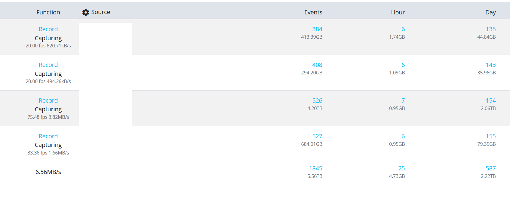

At least ZM thinks Reolink streams stop working quite frequently, causing recordings to be shorter than expected 10mins or oddly longer that said setting for example 17mins. Viewing stream from vlc shows it to be stable. Zoneminder show odd fps numbers for reolink cams, they are both set to 20fps, which they have been until now.
