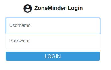

I have a problem now with the web page not showing correctly in my browser.
For example the login screen looks like this:-
Screenshot from 2023-06-23 11-09-52.png (16.8 KiB) Viewed 22233 times
when it should look like this:-
Screenshot from 2023-06-23 11-18-11.png (9.37 KiB) Viewed 22233 times
Any pointers to what might be causing this?

robfish wrote: Thu Jun 22, 2023 11:23 pm I have a problem now with the web page not showing correctly in my browser.
Check the javascript error logs. I have seen this error, though I can't say it's the same error (I haven't used bookworm yet). Hopefully if you find an error in the js logs you can search the forum and it may show up.

Thanks @burger , I opened the browser console and found this.
Can anyone suggest the possible cause of this (after recently upgrading to Debian 12)?

Just guessing. I don't have 1.36 w/ bookworm but hopefully this will help. You should edit the logs so they don't show your address. As to the error, a search on the forum comes up empty, which is interesting. Actually, this came up on the forum. I don't think this is it, but it's the closest hit. Try clearing the cache.
viewtopic.php?p=129065&hilit=jquery+is+defined#p129065
Do you have an adblocker or noscript running? Try another browser? This is the closest web hit: https://stackoverflow.com/questions/458 ... ith-source

Thanks for the help but unfortunately I still have the issue.
I cleared /var/cache/zoneminder/cache
It isn't my browser issue (I have tried Firefox and Chrome on two different computers)
I have two other remote Zoneminder servers on Bullseye still so I will not be upgrading them to Bookworm.
I think now the quickest fix is to completely rebuild this server (it has nothing else on it)

For now your best bet is to go back to Debian 11. There are no issues running Zoneminder there.
I am still researching ZM on Debian 12 as time permits. I suspect there may be some issues with PHP 8.2 but I am not that much of a wizzard to find them. I tried to install PHP 7.4 on Bookworm then install Zoneminder but PHP 8.2 got installed. I was able to get the API to work with ZmNinja but browsers other than Firefox tank out. Iconner will in time get a version for bookworm on the zmrepo so stay tuned!
