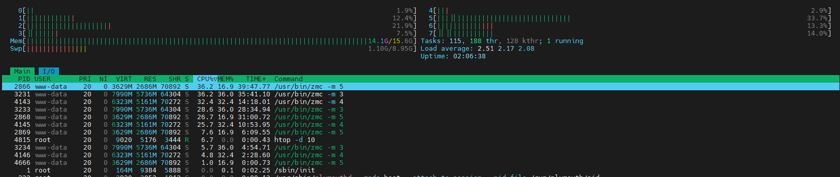

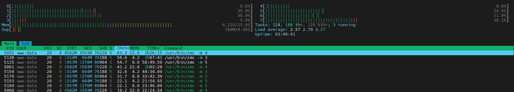

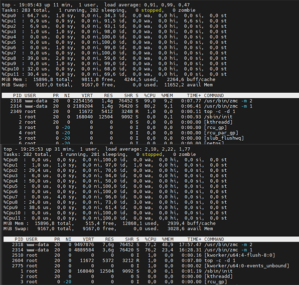

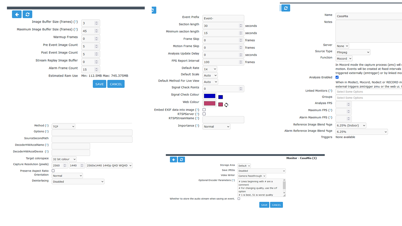

Re: memory leak in mocord
My settings:
Memory usage @ zoneminder start and after 20 minutes:
The only thing out of the ordinary there is the 15 alarm frame count setting...Can't imagine why that would cause a mem leak, but I can try it out here as well.
Cameras record at 15 fps and I set the alarm frame count to 15 to avoid flapping alarms.
I tried to leave everything at default but the situation does not change

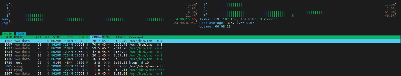

I moved HD to new HW: Xeon1230 V5 - 16 Gb ram
but I've got same problem
sometimes this appears in the logs (zmc_m4 and zmc_m3)
2023-07-15T16:13:17.760514+02:00 zoneminder136 zmc_m4[1702]: WAR [zmc_m4] [You have set the max video packets in the queue to 100. The queue is full. Either Analysis is not keeping up or your camera's keyf>
2023-07-15T16:13:17.760650+02:00 zoneminder136 zmc_m4[1702]: WAR [zmc_m4] [Found locked packet when trying to free up video packets. This basically means that decoding is not keeping up.]
