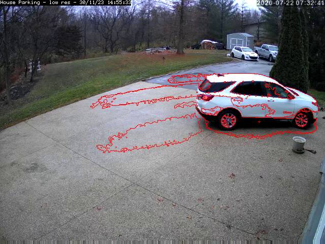

Here are two consecutive frames. When I look at stats some frames have two lines - an unnamed zone and one that I named. What's with the unnamed zone? I don't always see it in the stats so it must be something about the images that sometimes generates the unnamed one?
Had a bit of trouble making the stats columns like up so end up doing them as text without tabs and putting them in a code box. There is probably a better way to do this...
stats for frame 80
Zone  Pixel Diff  Alarm Px    Filter Px   Blob Px   Blobs Blob Sizes        Alarm Limits    Score
         64      40666 (0%)   34397 (0%) 32287 (0%)  2   8038-24249 (0%-0%)  190,144-626,300 10
Parking  55      52074 (19%) 42638 (15%) 26829 (9%)  1   26829 (9%)          178,144-626,272 9
Frame 81
         64      39787 (0%)   33969 (0%)  31896 (0%)  1   31896 (0%)  209,144-637,299 10
Parking  55     51168 (18%)   41909 (15%) 37753 (13%) 1   37753 (13%) 170,144-637,309 13

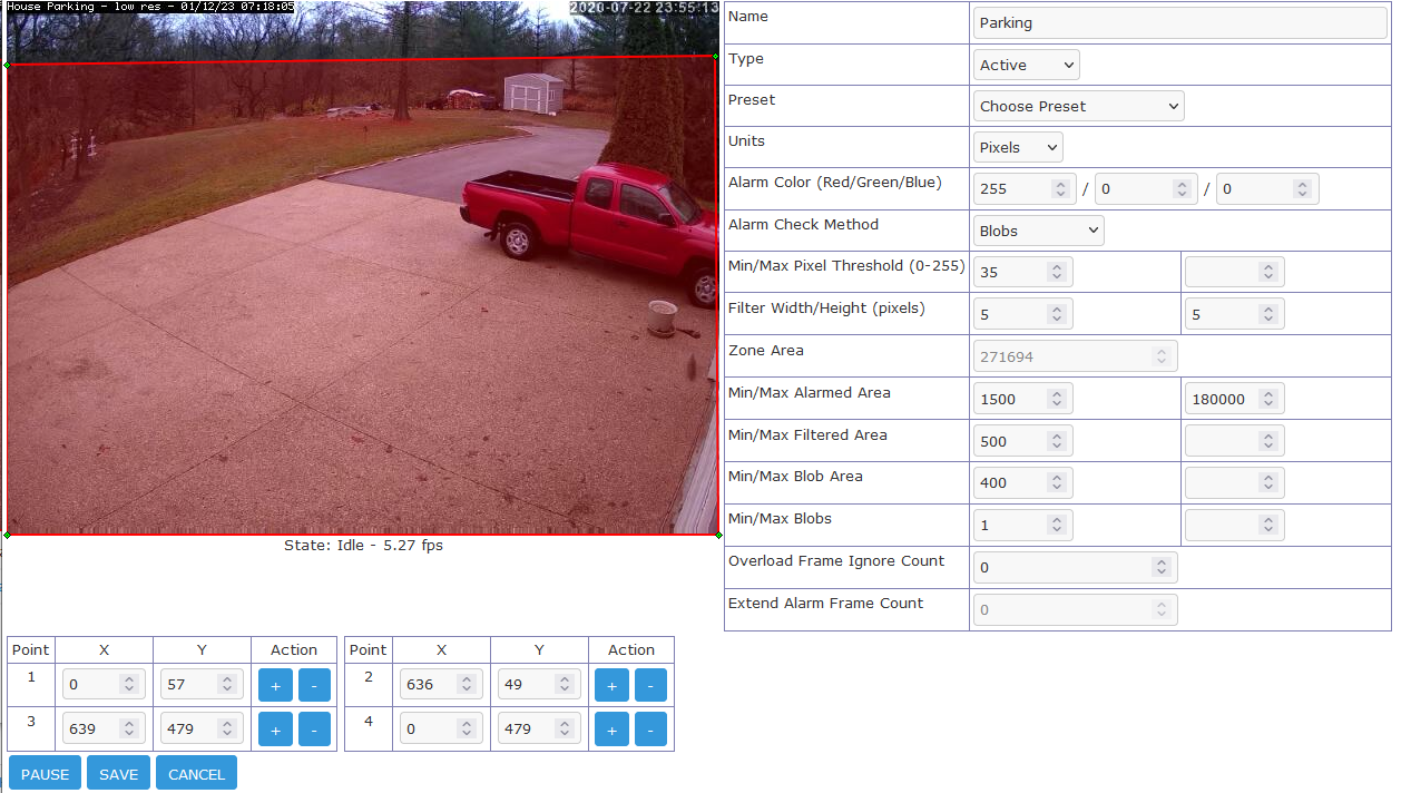

I started by drawing a zone for what I figured was a small car at the farthest distance and the pixels for that was 1500 so used that for my settings and didn't keep that as a zone. Looks like I need to increase the minimums for an event but want to better understand things. Also will adjust the buffer alarm frame count to avoid single frame triggers - thinking about 3 - 5.
Main question is why I have the large areas outlined in red where there doesn't seem to be any changes in that area for many previous frames.
