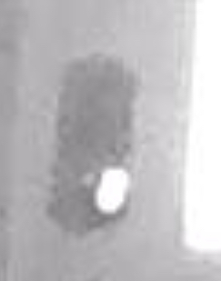

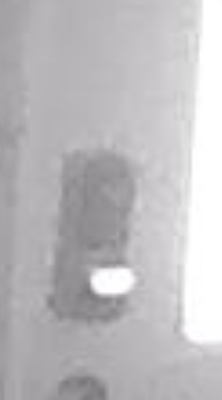

Paid attention this time and got proper reflective tape. A strip along the long axis of the handle shows up nicely when the IR LEDs wars lit up. Gonna cut a thinner strip so it'll be even more obvious.
Handle is horizontal, locked.
Handle is vertical, unlocked.
