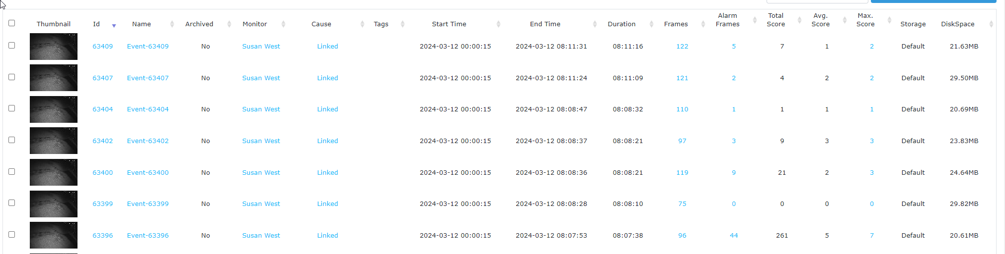

Looks like Linking is very broken.
No longer causing Seg faults but now they are creating 100's of events all at the same time.
Note the number of frames vs the size of the files and durration.
I am using Version: 1.37.55~20240310110432-focal
The log file has lots of:
The low resolution monitors that these are linked to appear to work fine.
What are my next steps?
Linked Cameras Creating Events within Events
