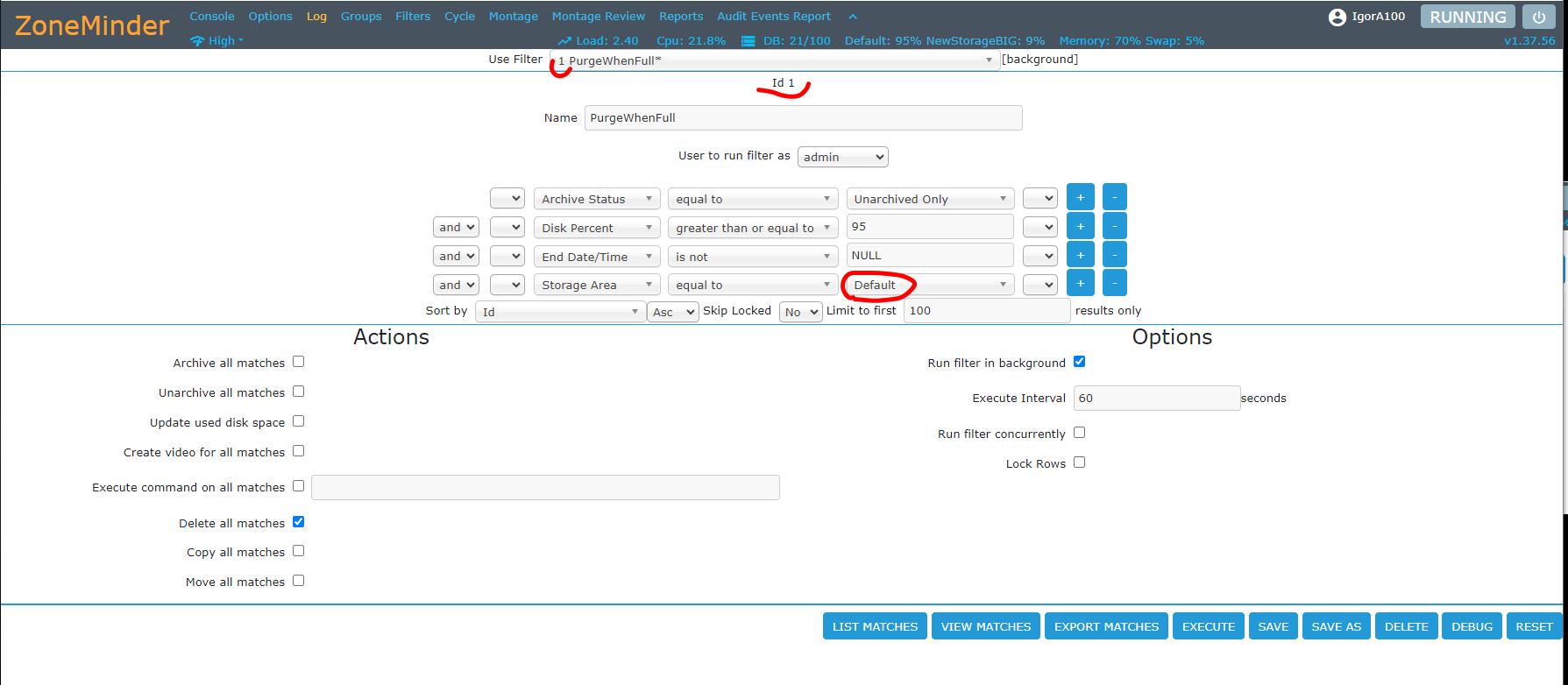

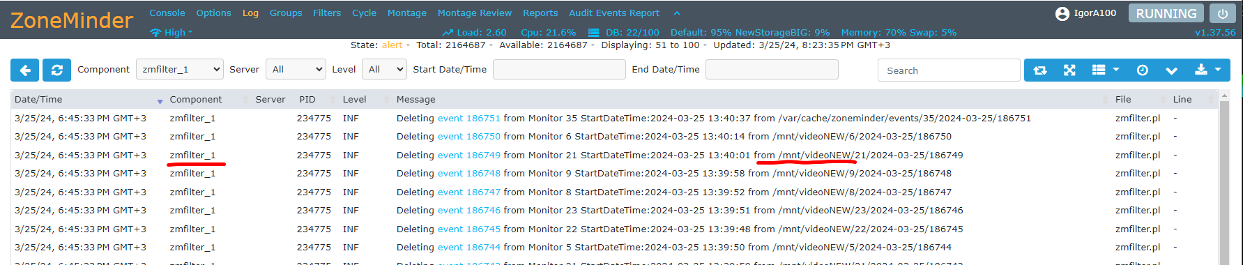

I'm confused...
It turns out that events from a storage that was reconnected are deleted by a completely different filter, which is configured for the default storage location.
How can this be?
How can this be?
- 501.png (52.79 KiB) Viewed 2149 times
- 500.png (54.57 KiB) Viewed 2149 times
Re: Problem with stored events when disconnecting and reconnecting storage
I don't understand anything at all...
I had one monitor whose recording settings indicated: Storage Area = Unspecified, and it recorded to the default storage.
When I changed his settings to Storage Area = Default, then all storage began to be cleared correctly.
There must have been some kind of glitch...
