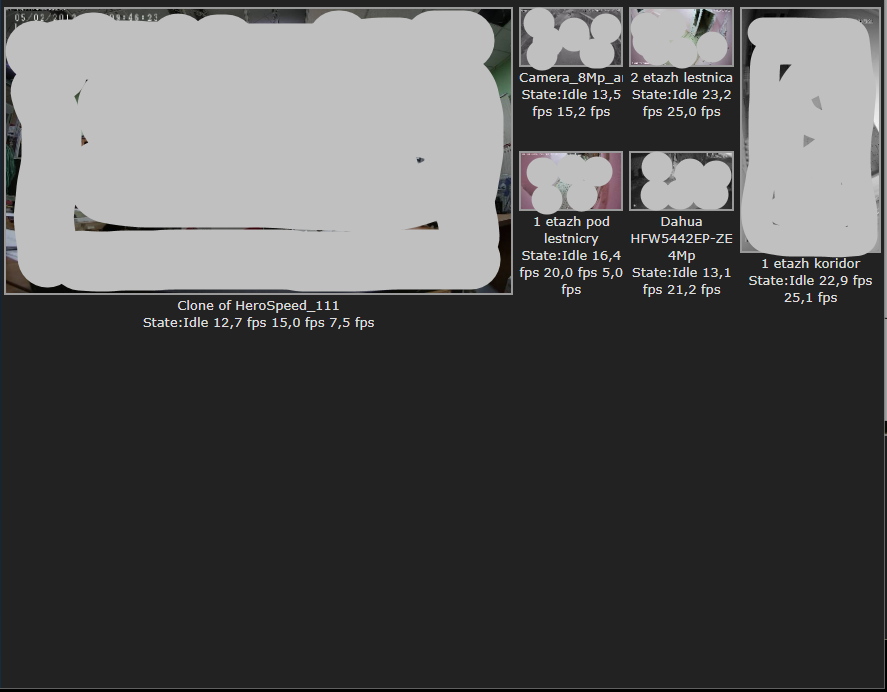

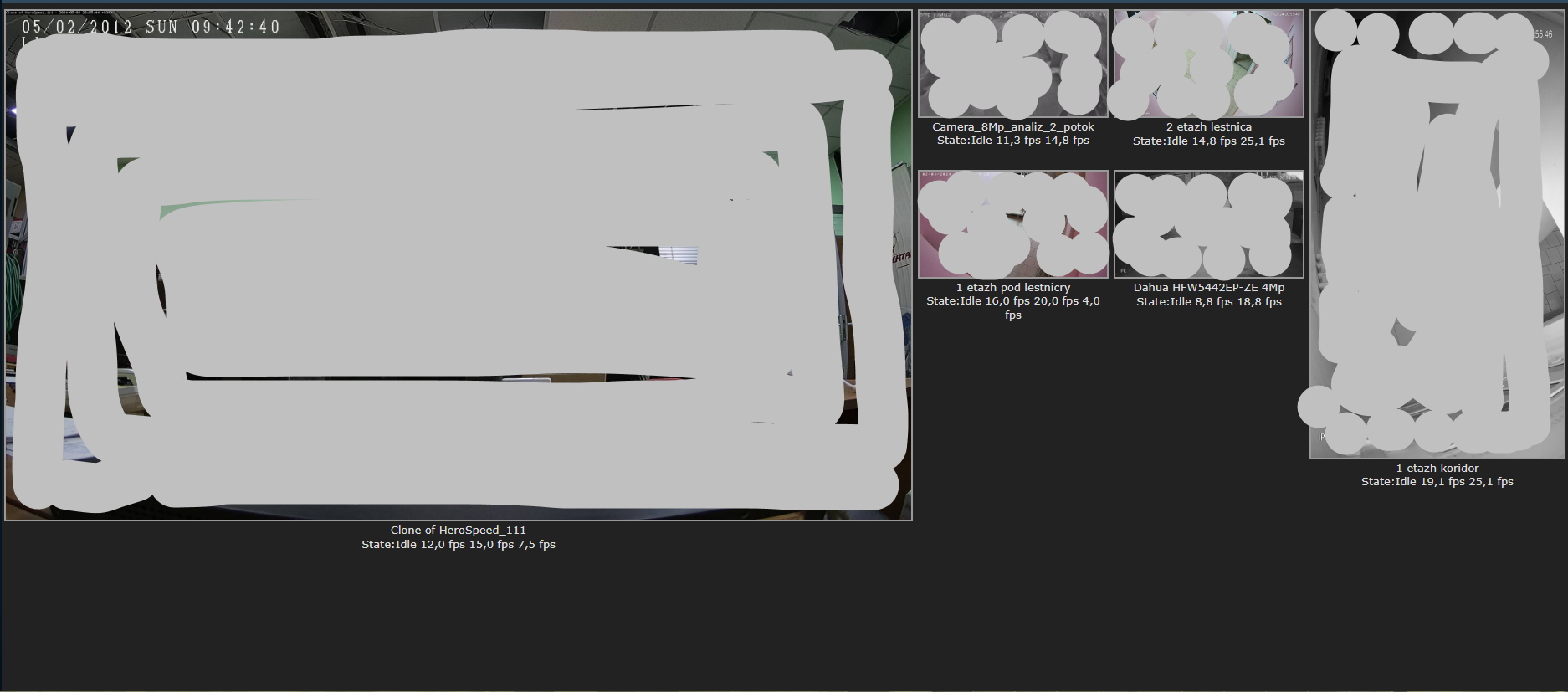

Scaling:
The font size is the same on both screenshots!
