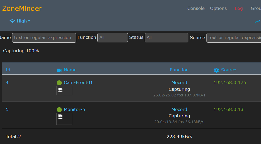

see attached, now all my cameras are not displaying live view, thumbnails look weird, CPU for "zmc" is 160%+ and 80%+
- zoneminder-2.png (28.46 KiB) Viewed 2882 times
Re: Control Hikvision DS-2DE4425IW-DE
fixed the liveview, now it seems zoneminder works fine if I never touch the control arrows. If i do the system takes a total dump, CPU spikes, web site crashes, and eventually zmc crashes
