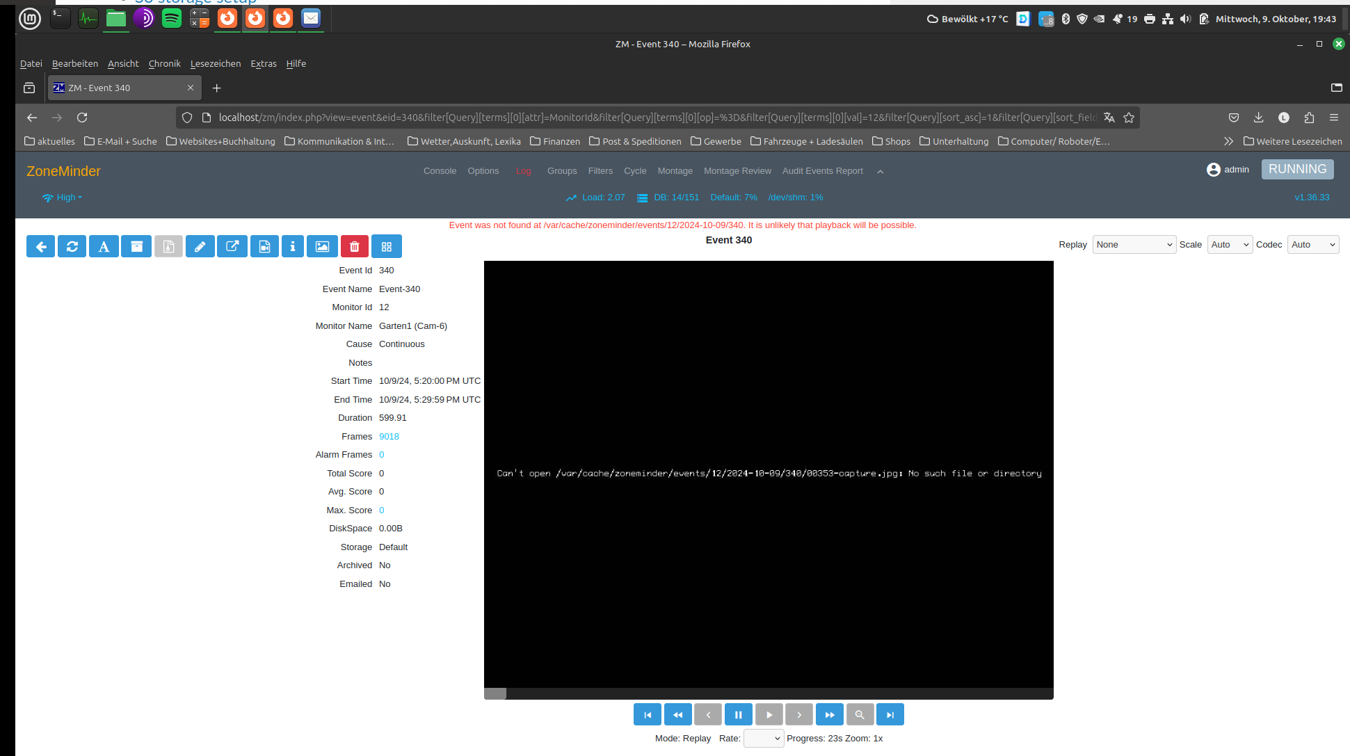

Unfortunately Zoneminder doesn't record. Is it possible to show me how to make the motion-controlled recording work?

Default storage for Zoneminder is /var/cache/zoneminder/events. Although you may want to consider using external storage. See this link for instructions: https://wiki.zoneminder.com/Using_a_ded ... Hard_Drive
Check that permissions are correct. They should be www-data:www-data. Check that the folders are being created. Also, your log is showing as red on the top nav bar. Check that, maybe the timezone is incorrect or something.
Other than that, I'm not sure why it is not recording, but we should be able to figure it out. Check the above, and if that does not work then go into Options - Logging - LOG_LEVEL_FILE and set to Info. Restart ZM and go to /var/log/zm and see what the logs say.

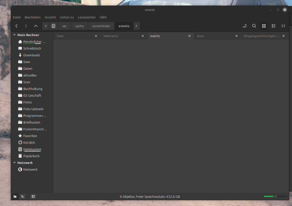

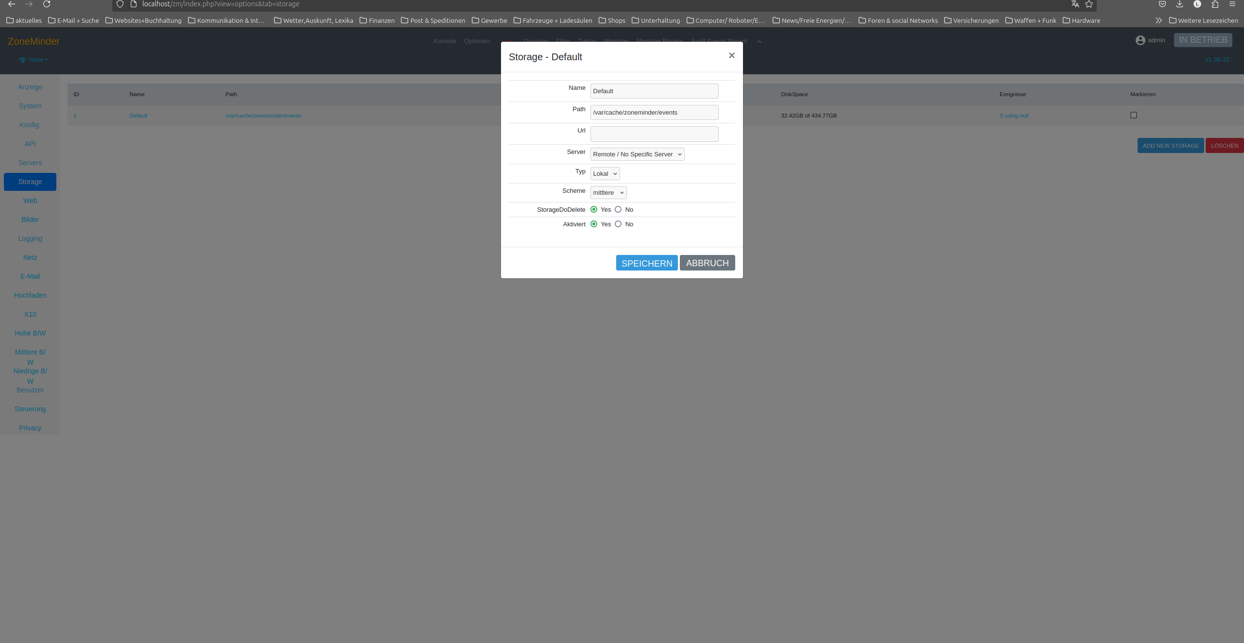

Thank you for your feedback and your help. I have cleared the time zone. It doesn't have to be an external storage device. If possible, the oldest files are always deleted automatically. I have attached a screenshot showing the storage settings in zoneminder and also the storage path; no folders are created there. Where should www-data:www-data be entered, under URL?

Svenbobot wrote: Wed Oct 09, 2024 8:26 pm 10/09/24 22:14:35.913324 zmc_m5[247471].ERR-zm_monitor.cpp/678 [Can't mkdir /var/cache/zoneminder/events/5: Permission denied]
What does ls -l /var/cache/zoneminder say?
You probably have to:
chown -R www-data:www-data /var/cache/zoneminder
