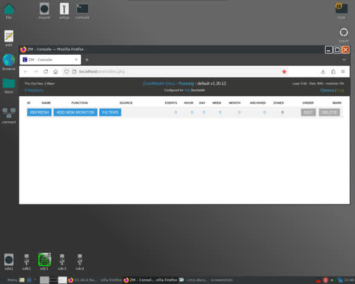

Re: V1.30.4 Remastered
I will update this post with a result. I do have ZM130 running on a fresh install of Puppy Linux the NoblePup64 variant.
ZM starts after some juggling to adjust some of the web server infra structure.
It was installed with a combination of Method 1 and Method 2. I feel ZM130 will work well once I hammer out the kinks.
* Stay tuned.
A problem has occurred, Setting up a local webcam after configuration attempting to save a Monitor-1 throws the following error:
FAT SQL-ERR 'SQLSTATE[22007]: Invalid datetime format: 1366 Incorrect integer value: '' for column `zm`.`Monitors`.`V4LMultiBuffer` at row 1', statement was 'insert into Monitors set LinkedMonitors = '', Name = 'Monitor-1', ServerId = '', Type = 'Local', Function = 'Monitor', Enabled = '1', RefBlendPerc = '6', AlarmRefBlendPerc = '6', AnalysisFPS = '', MaxFPS = '', AlarmMaxFPS = '', Protocol = '', Host = '', Port = '80', Options = '', Path = '', User = '', Pass = '', RTSPDescribe = '0', LabelFormat = '%N - %m/%d/%y %H:%M:%S', LabelX = '0', LabelY = '0', LabelSize = '2', ImageBufferCount = '150', WarmupCount = '10', PreEventCount = '60', PostEventCount = '50', StreamReplayBuffer = '300', AlarmFrameCount = '1', Controllable = '0', ControlId = '0', ControlDevice = '', ControlAddress = '', AutoStopTimeout = '0.00', TrackMotion = '0', TrackDelay = '0', ReturnLocation = '-1', ReturnDelay = '0', EventPrefix = 'Event-', SectionLength = '600', FrameSkip = '0', MotionFrameSkip = '0', AnalysisUpdateDelay = '0', FPSReportInterval = '1000', DefaultView = 'Events', DefaultRate = '100', DefaultScale = '100', WebColour = 'red', Exif = '0', SignalCheckColour = '#0000c0', Device = '/dev/video0', Method = 'v4l2', Channel = '0', Format = '255', Palette = '0', V4LMultiBuffer = '', V4LCapturesPerFrame = '1', Colours = '3', Width = '640', Height = '360', Orientation = '0', Deinterlacing = '0', Sequence = 1'

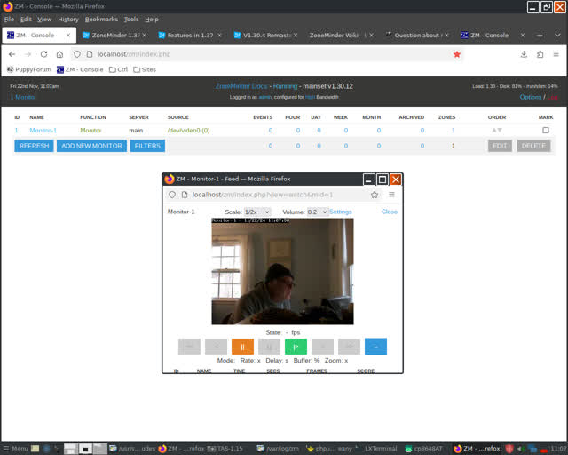

I am getting closer!
the webcam LED is turning on for a few seconds and then zmc is crashing.
This is in a terminal shows no messages. I have the /dev/video0 owned by www-data (Apache and ZM)
Before I did the work around you've shared, I was trying again and filled out the config slightly different and BOOM! it worked.
I selected this differently by selecting Yes instead of Use Config Value->
Multi Buffering Yes No Use Config Value
But I am getting only a camera up for a few seconds......so much closer...it's almost working!

I changed the res to 640x480 which the webcam is set too and it's up and running!!!
I had almost forgotten that ZM 1.30.4 is very picky that the camera resolution must be exact or the stream will fail
*** One more thing is I can not start ZM130 using /etc/init.d/zoneminder130. So far to start ZM130 it works using the web console.
Will start to look at why this is.......might be a Puppy Linux difference.....
Also no status or FPS are displaying any values:
It looks like the Monitor window hasn't finished setting up which is why the stats and the alarm links aren't showing up. There is an error that is keeping it from finishing the setup of the window. I'm gone for the weekend, but when I get back, I'll set up a Puppy Linux virtual machine and figure out what is needed to make it work 100% on that system.
