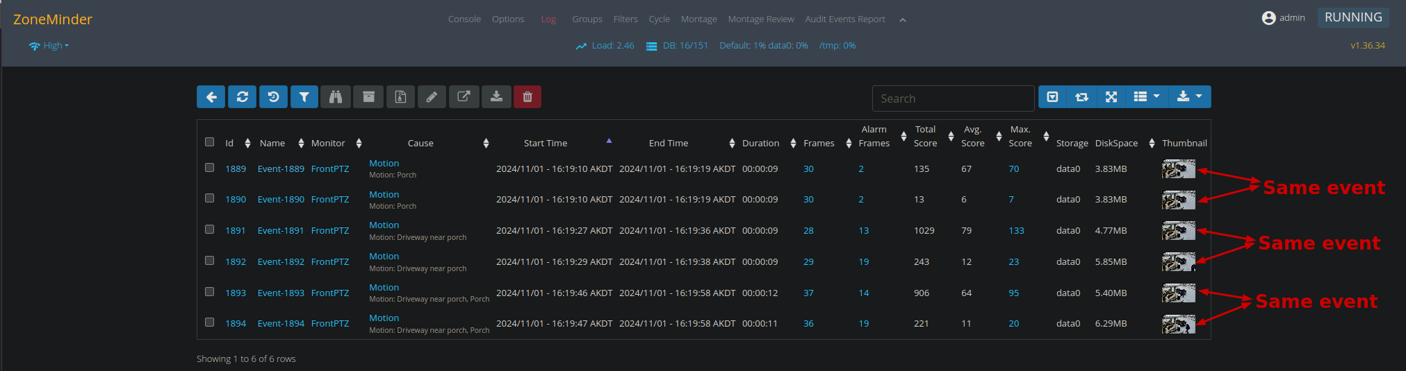

I am not sure what I have done to get this result, but each of my modect events are storing twice under my new storage location. Where do I need to look to fix this?

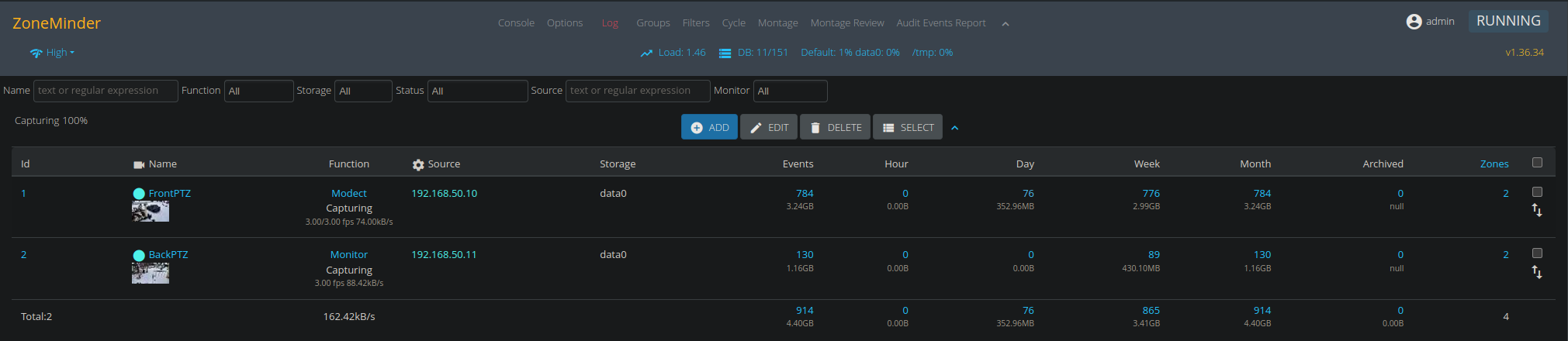

Let's see your monitors. (Console)
Re: Same event stored twice
Posted: Sun Nov 03, 2024 6:04 pm
by eracc
Here is the console.

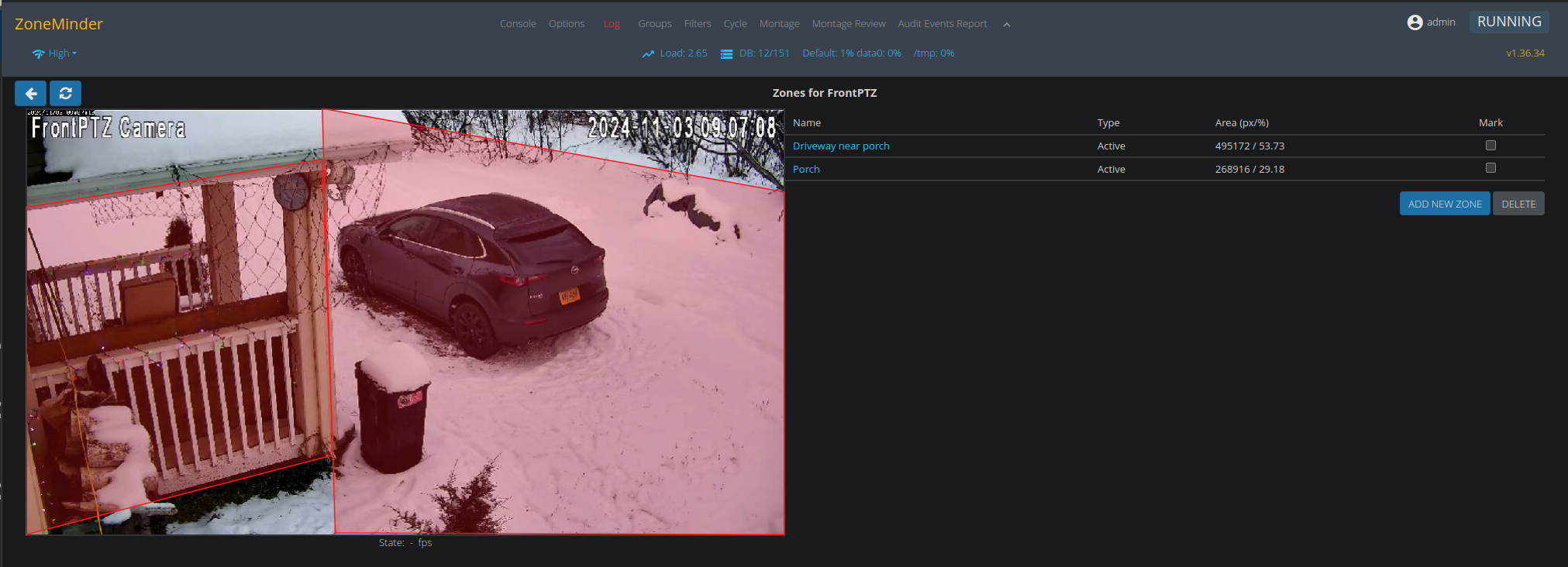

Before you ask, here are the zones. ;)

I think what is happening is that your camera has a large keyframe interval. We always have to start a recording with a keyframe, so we have to rewind in the queue till we find one. I think we are going back to the same start keyframe as event 1.
Maybe increase the minimum event length, or decrease you keyframe interval in the camera.
