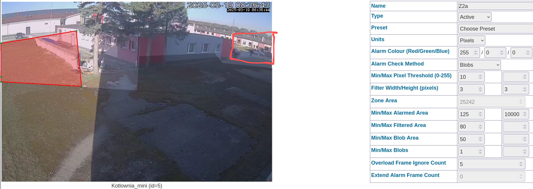

In my case it's permanent on two cameras:
Dahua model IPC-HFW2320R-VFS-IRE6
Cars are passing in a red highlighted part of the image, right up corner.
When car is passing activ zone Z2a detects motion on the left side. Other zones are set inactiv.
looks like image is flipped y axis before analysis.

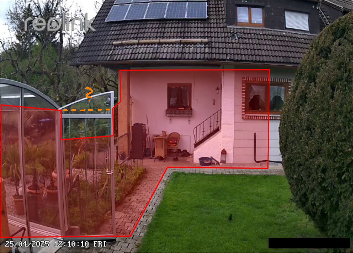

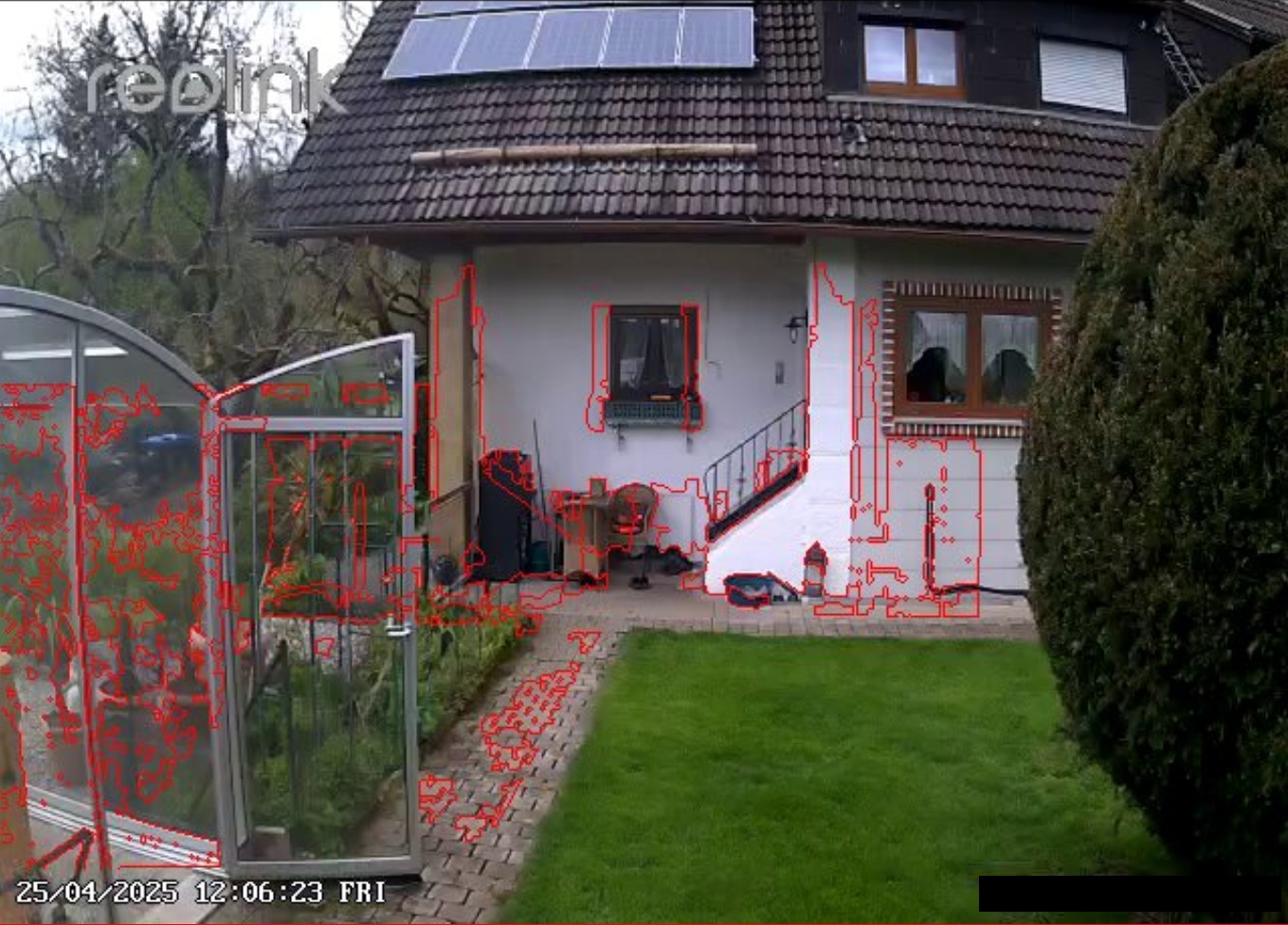

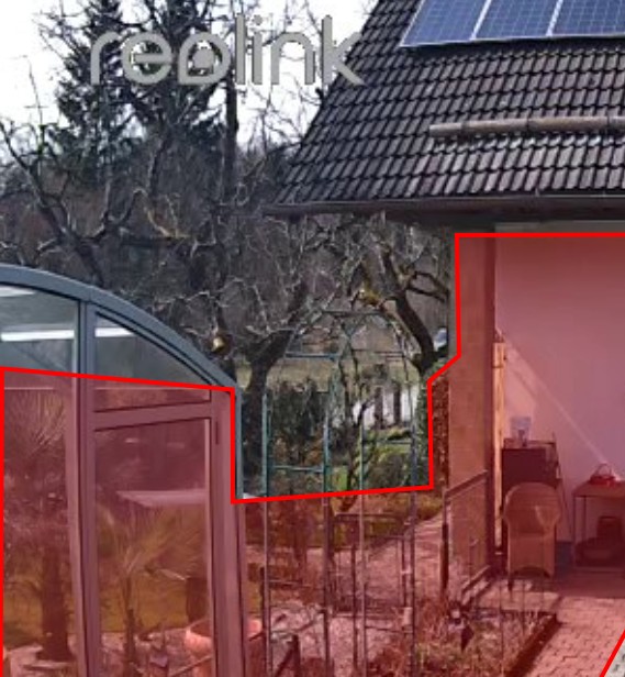

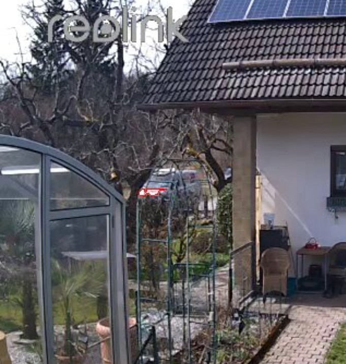

Adding on to this that I have the same problem and had for a while. For me, cars are passing by the only defined zone (both on the left side of the image) and getting blob detected anyway. For me, it's on an 640x480 lowres RTSP stream from a Reolink Webcam. I've also tried deleting all zones and re-adding them, to no avail. I'll add some screenshots to showcase the issue, please let me know if I can do anything else to help pinpoint the problem.

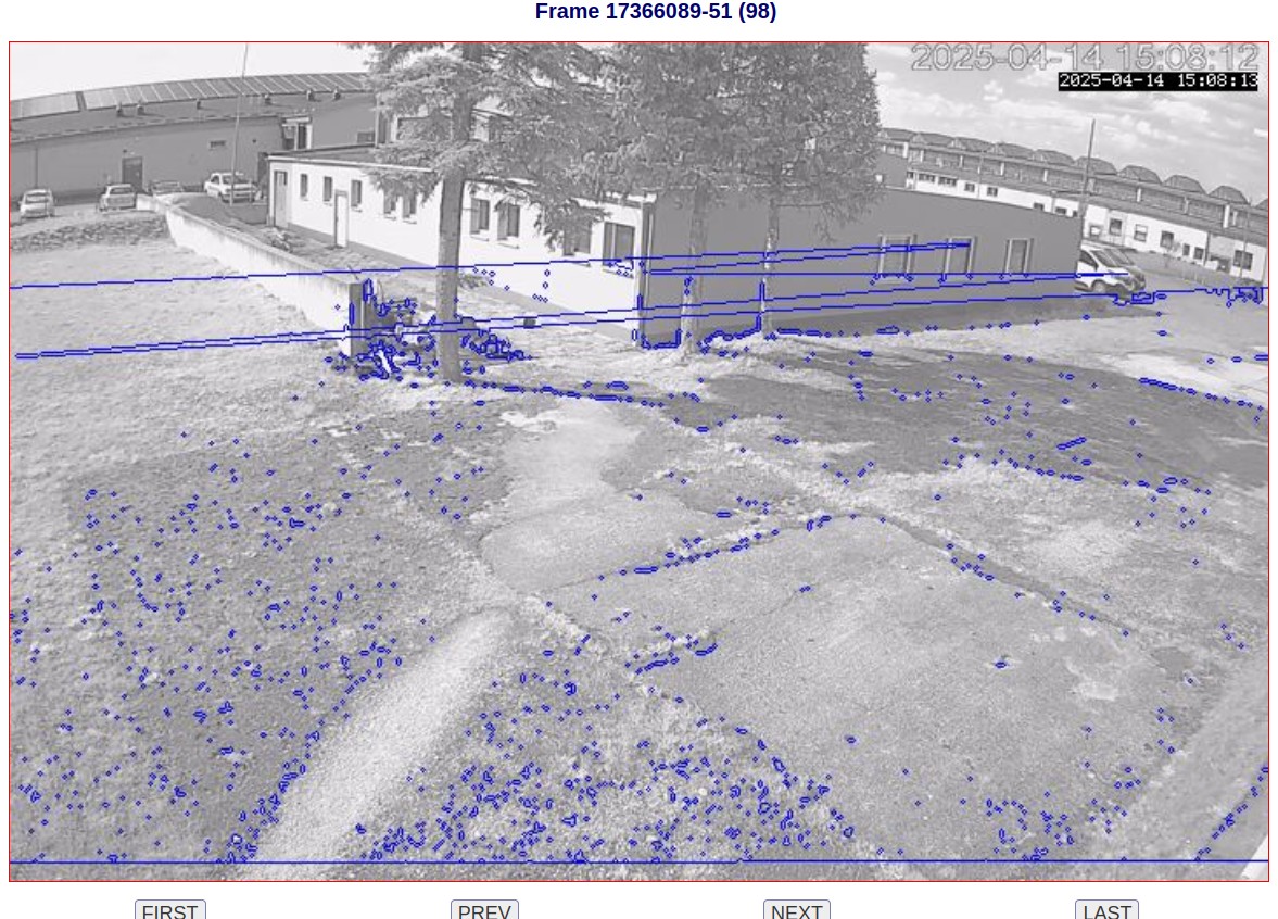

- enable jpg analysis frames
- Trigger a max-motion picture (by camera) e.g. by changing day/night mode (hikvision). This will create a white flash on every switch that will trigger every active pixel/blob so the analysis frames should show a pixelcloud of the true areas. Compare it with the originally defined areas.

Here is another example.
Image Image Image Image Image

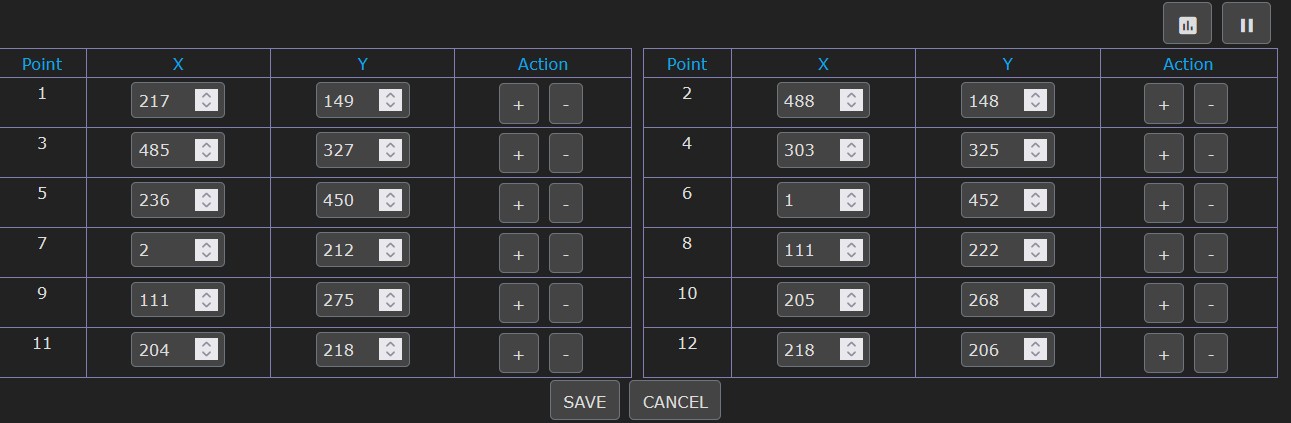

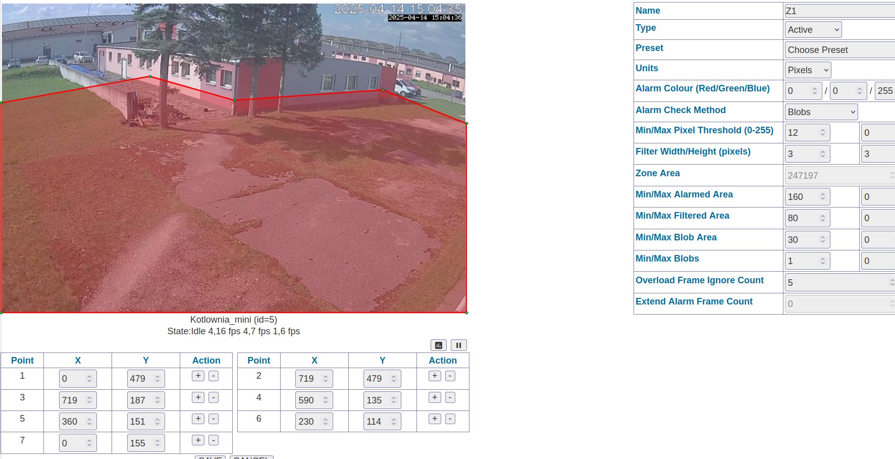

This is my zone with parameters and detected area (pixel / blob)

I've flipped my image horizontally in the camera to simulate an "all pixels changed" situation and got this:
Kinda looks like it's drawing lines where it should not or something
