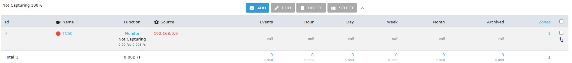

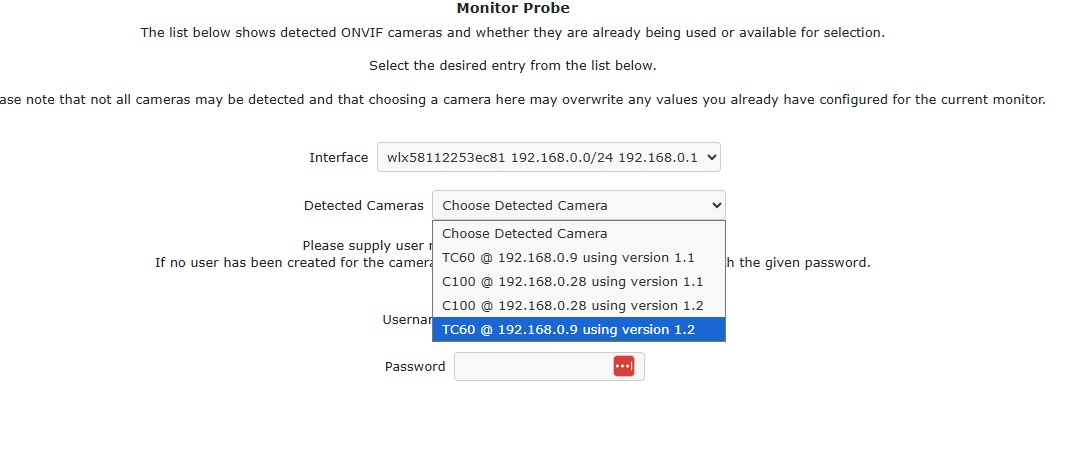

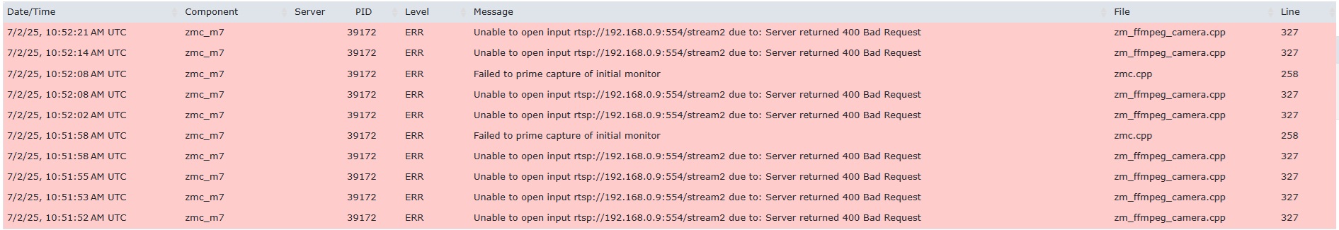

Hello, Newbie here. I am having a similar issue.
ZM v1.36.35
Lenovo Think Centre with Ubuntu
Tapa TC60 and C100
I can scan it in with the ONVIF Monitor Probe but it doesn't capture.
If I used jpeg I get a flickering picture and a screen screen. I feel I am close.
